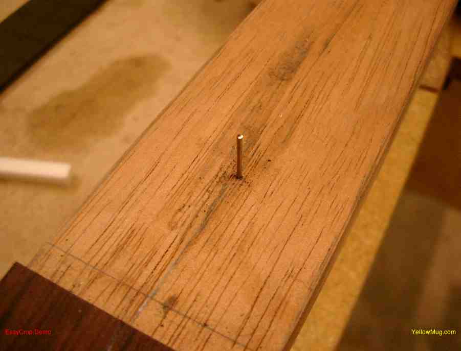

   I use the position dots as a hide away for the pins. Align the neck and I use a tiny brad, Drill 2 holes under the pearl location and through the board into the neck. you can now set the pearl, this leaves holes. 2 on the board and the 2 in the neck you drilled .
    using the small brads as locating pins you can set them to the holes and clamp the board knowing it is in the postion you set it.

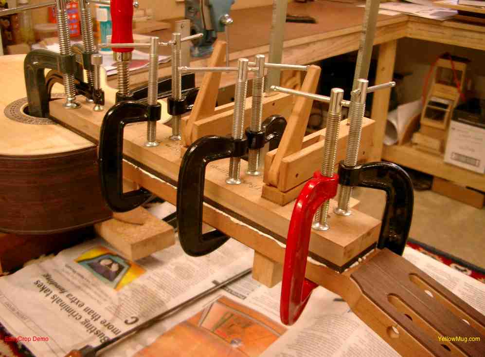

PostPosted: Sun Jan 07, 2007 11:25 am
James...Here's how I do it:
1)Install all but 2 of the frets. I leave the first fret slot and the 13th slot unfretted (11th slot if it's a 12 fretter)
2) Perfectly align and clamp the FB to the neck
3) Drill a 1/16" hole through the treble side of the 1st and the bass side of the 13th and just a tad through the neck surface
4) Apply your favorite glue (I use epoxy) and insert the smooth ends of 1/16" bits (or smooth pins) through the holes and into the neck surface.
5) Clamp it up and have a beer! Remove the pins after the glue sets up...about 30 minutes with the epoxy I use.
6) Allow to set for 24 hours, unclamp and install the 2 frets

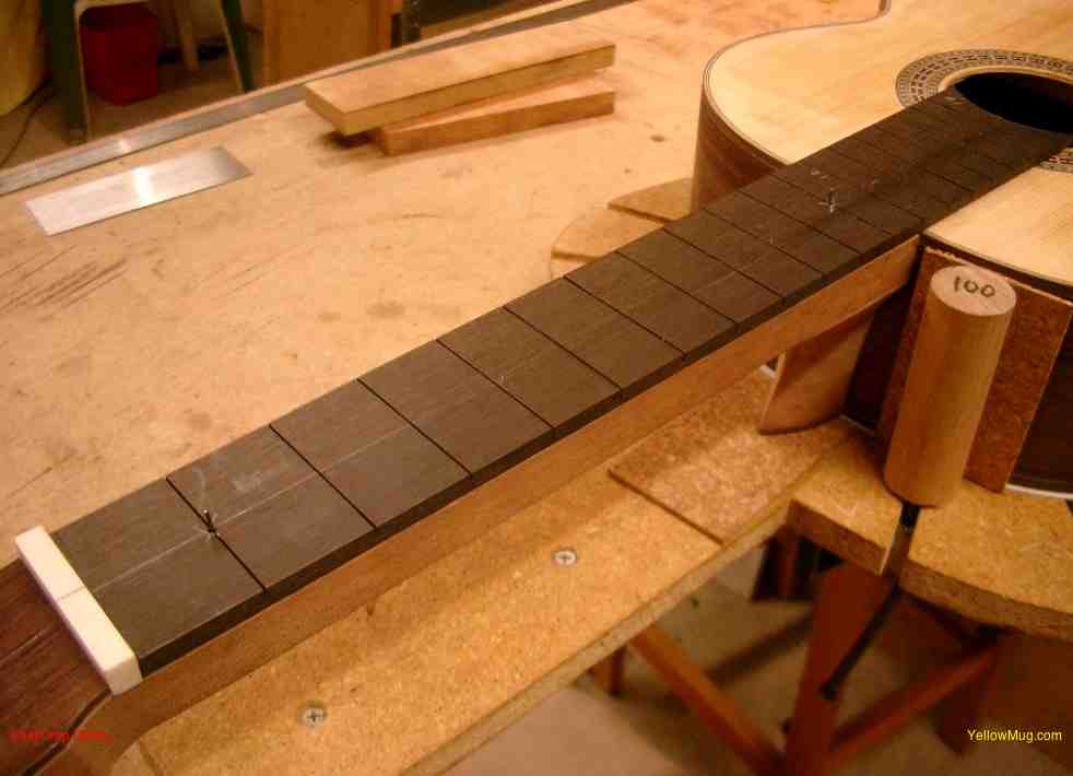

PostPosted: Sun Jan 07, 2007 3:00 pm
James, i did that on no 2, the same way Kathy Matsusita does except that i cut 2 very tiny finishing nails in half and pushed them through the fret slots with a very small punch, a tad deeper than the slots were, no chance of moving whatsoever. Of course, i did drill 2 tiny holes first.

I do it slightly different. I have a template that matches my fretboard and
neck taper that has 2 holes drilled through it, one in the 1st fret area and
one down around the 12th I do believe.
I align the template on either piece, order doesn't matter, and with the drill
press drill the 2 holes into the neck and backside of the fretboard (very
shallow-about a 1/16th on each). I then take a cross-section of hot dog
roasting stick about 1/8" tall and glue into the holes I drilled into the neck.
Apply glue, then align and place the fretboard's corresponding holes onto
the stub of the protruding stick and clamp.

Something I learned from Mark Swanson several years ago, shoot a couple of staple from a staple gun to the underside of the fb. The wood is so hard that the staple barely sets into the wood. Nip off the ends to just leave a little nib of the staple, align the board and press down into the mahogany. Now you can take off the board, apply the glue and reset into the holes and your good to clamp. Staples stay in the neck, sort of the same as Kevin's and Chris'
